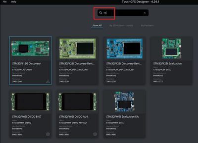

I have a board STM32F413 disco. How can I use TouchGFX to display on LCD on this board?
I have found the template in TouchGFX but I didn't see it.
Is there any way? that I can display LCD on the STM32F413 disco, or where I can find an example to sourcode for this.
2024-11-29 7:43 AM - edited 2024-11-29 9:13 AM
Unfortunately, there is no TouchGFX Board Setup for STM32F413 disco available on TouchGFX designer.
Only STM32F412 Discovery is available as template.
The available TouchGFX designer templates for F4 boards:
See also this thread: https://community.st.com/t5/stm32-mcus-touchgfx-and-gui/touchgfx-on-stm32f413h-disco-board/m-p/207376

@HAnh here's a thread on setting up for a custom board:
