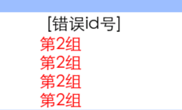

Thank u for your advice. It works. However, I plan to implement a combination display of Chinese and dynamic numbers in a TextAreaWithOneWildcard , like“第%d组”,But it seems that there is no such function, and I can only continuously convert values to adapt to the sprint function in C language, but it still shows failure
2023-11-08 8:02 PM
By converting a char type string to const uint8_ t* and function of Unicode:: from UTF8 (); I succeeded! the red characters in touchgfx design are the result which are corresponding the code sprintf(id_temp,"第%d组",2);

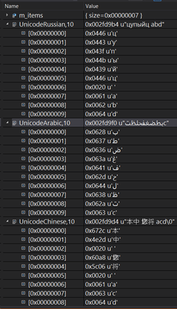

I use u"" approach:
static constexpr char16_t const * const UnicodeRussian = u"цупыйц";
static constexpr char16_t const * const UnicodeChinese = u"本中 您将";
static constexpr char16_t const * const UnicodeArabic = u"بطضغفحلظت";
Now, all strings are Unicode and can be used with cast:
reinterpret_cast<touchgfx::Unicode::UnicodeChar const *>( UnicodeChinese )
