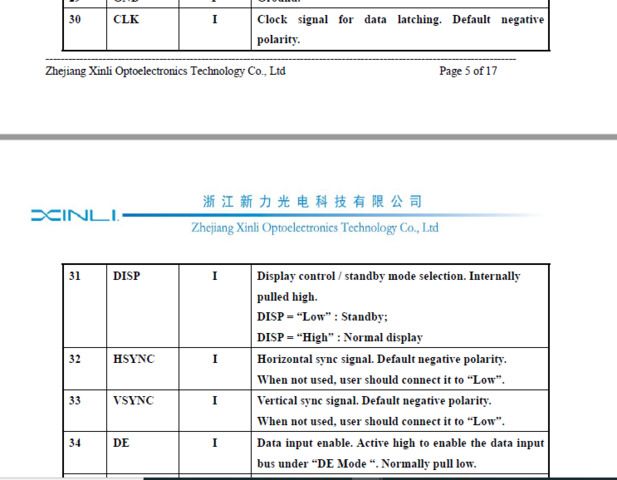

Also did you check LTDC polarities ? May be that is wrong.
Below are my LTDC settings:
horizontal synchronization polarity : Active Low
vertical synchronization polarity : Active Low
data enable polarity : Active Low
pixel clock polarity : Inverted Input pixel clock ( tried Input pixel clock polarity too)
Below screenshot is from datasheet:

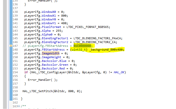

When i see your images from first post, this dont seems as ltdc trouble. Try check firstly display and ltdc without touchgfx started.
I mean your troble is SDRAM when you use external.
For test only display prepare in flash memory fullscreen image in proper format and replace address in ltdc layer config to this image.
Then in main disable starting touchgfx resp all rtos.
2020-10-15 11:09 AM
@MM..1 Thanks for the comment.
You mean something like below screenshot. Here I replaced "color frame buffer address " to background image array _background_800x480 (generated by touchgfx stored in internal flash) from SDRAM address 0xC0000000. I don't have display with me right now to validate. I will send it to factory for validation.
Why do you feel like that its might be SDRAM issue ? Just wanted to know the reason,

2020-10-16 6:50 AM
yes as you write static image data and in main add comment to line osKernelStart
/* USER CODE END RTOS_THREADS */
/* Start scheduler */
//osKernelStart();
/* We should never get here as control is now taken by the scheduler */
/* Infinite loop */
/* USER CODE BEGIN WHILE */
while (1)
/* USER CODE END WHILE */
/* USER CODE BEGIN 3 */
in this config you need handle all hw init to ok display, only after this you can use TouchGFX process.
And you ask why SDRAM. TouchGFX use for output only RAM internal or external and all graphics is copied, moved handled in this RAM.
When you set ChromART D2DMA is used for manipulate and may go to timing or other conflict . Your SDRAM test dont test DMA speed transfers.
