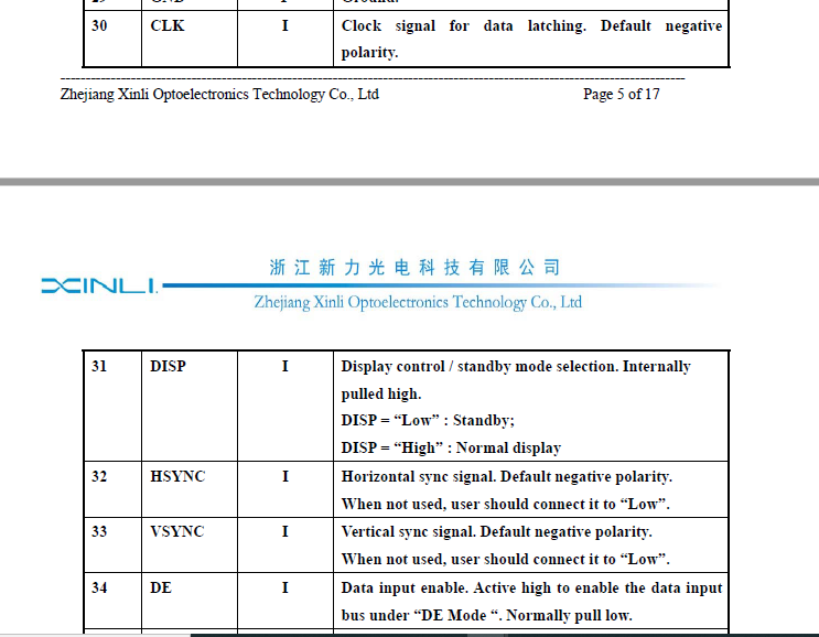

Hello, I am using display TCXD050ABLON (Data sheet Attached) with STM32F746. As per datasheet I did below LTDC setting and still display is flickering badly.

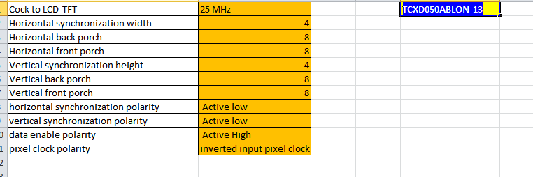

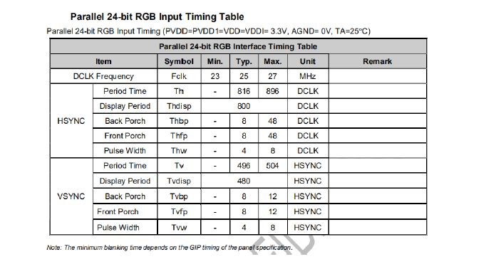

Few screen shots of display setting as per datasheet is below.

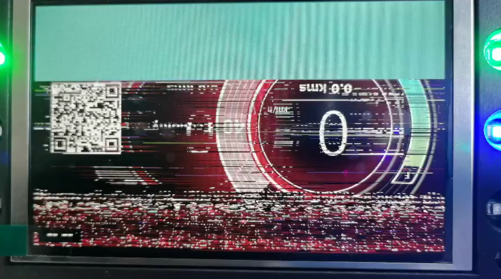

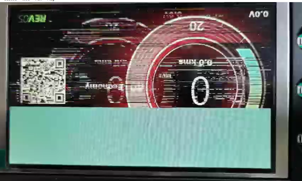

Few Images of flickering display is as below.
Any suggestions?

When i see your images from first post, this dont seems as ltdc trouble. Try check firstly display and ltdc without touchgfx started.
I mean your troble is SDRAM when you use external.
For test only display prepare in flash memory fullscreen image in proper format and replace address in ltdc layer config to this image.
Then in main disable starting touchgfx resp all rtos.

Btw did you check my LTDC setting ? Does it look correct as per requited TFT settings?
Can you please check? I put few screenshots of datasheet down in post.

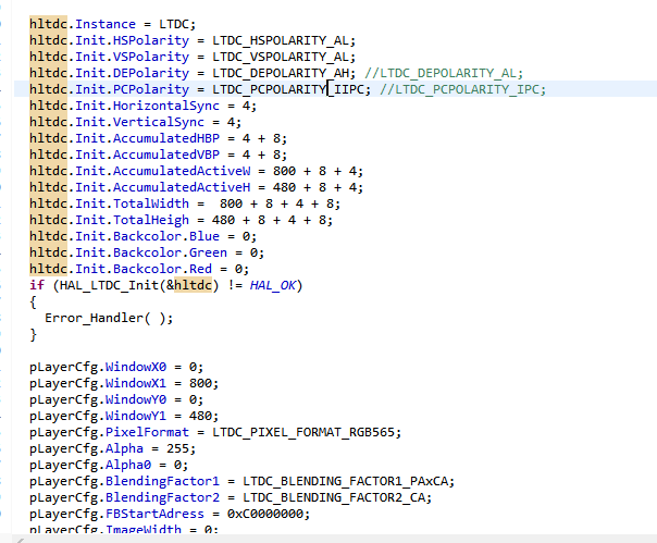

I am using internal flash for initial testing. Also have used CubeMX for initial settings. As display was flicking I was changing paraments like AccumulatedActiveH directly from code.
I feel like issue is with horizontal synchronization, vertical synchronization, data enable, pixel clock polarity. Is it fine as per you ?

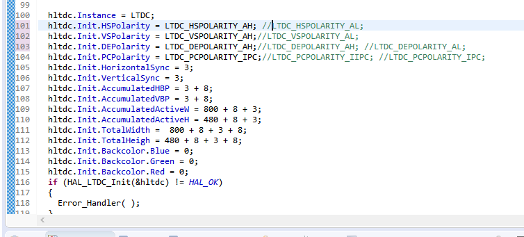

I tried below combine too.

I guess you tried the config LTDC_HSPOLARITY_AL, LTDC_VSPOLARITY_AL, LTDC_DEPOLARITY_AL and LTDC_PCPOLARITY_IPC.
Please try try to remove you image and put a box instead, does it display correctly ?
Could you show me your clock config ?
/Alexandre

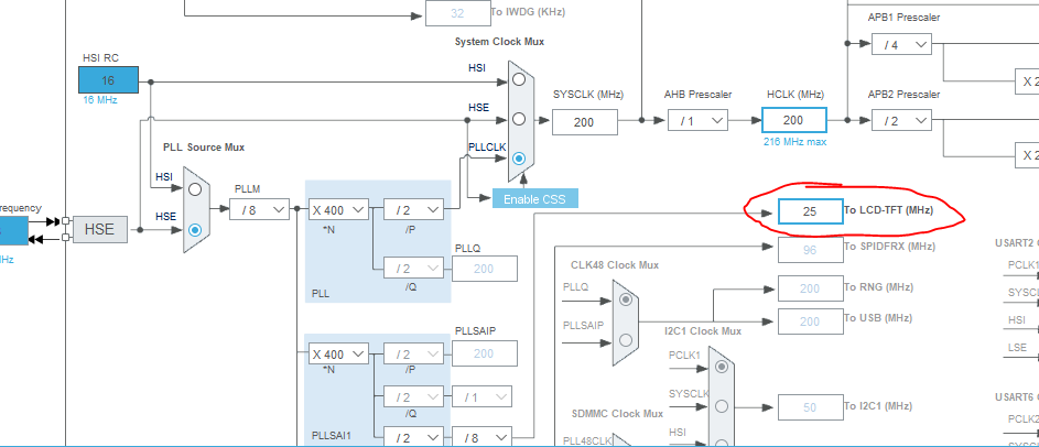

2020-10-08 10:19 PM
@Alexandre RENOUX My clock settings are as below ?
Also Does correct config is LTDC_HSPOLARITY_AL, LTDC_VSPOLARITY_AL, LTDC_DEPOLARITY_AL and LTDC_PCPOLARITY_IPC ?
2020-10-09 12:10 AM
Yes I do think that the config I mentioned is the correct one.
Maybe could you try changing the LTDC clock to something lower (9.6 MHz for example like the F746G-DISCO) and see how it behaves ?
/Alexandre

@Alexandre RENOUX
One doubt, Horizontal sync signal. Default negative polarity, When not used, user should connect it to “Low�?. means it should be LTDC_HSPOLARITY_AH. I think.
Also same doubt for others polarity. Can you please clear it.
