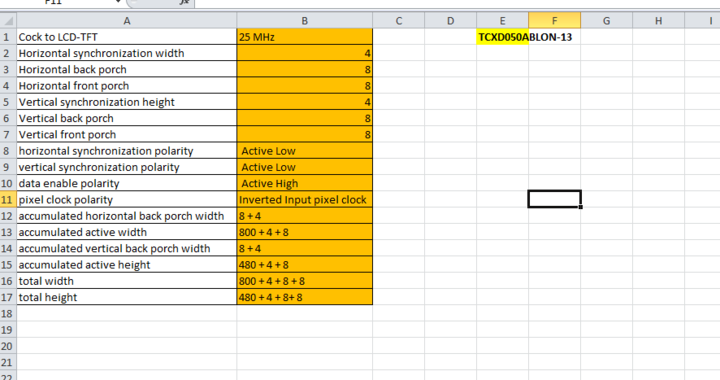

Hello, I am using display TCXD050ABLON (Data sheet Attached) with STM32F746. As per datasheet I did below LTDC setting and still display is flickering badly.
Few screen shots of display setting as per datasheet is below.

Also below are my LTDC settings.

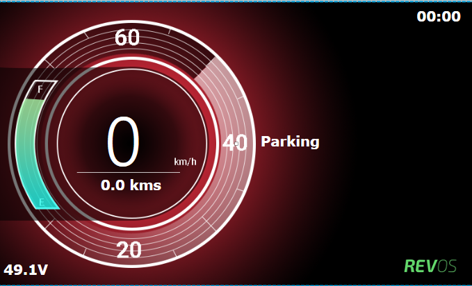

Okay, that definitely looks like an LTDC configuration issue, yeah. Can you show me what the intended output is? e.g. from simulator
2020-10-13 6:32 AM
@Martin KJELDSEN Even i m thinking same. Did you check my LTDC settings?
Below is output image:
