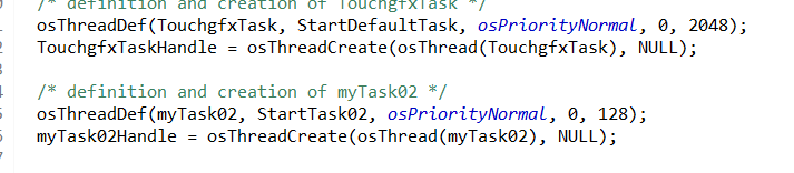

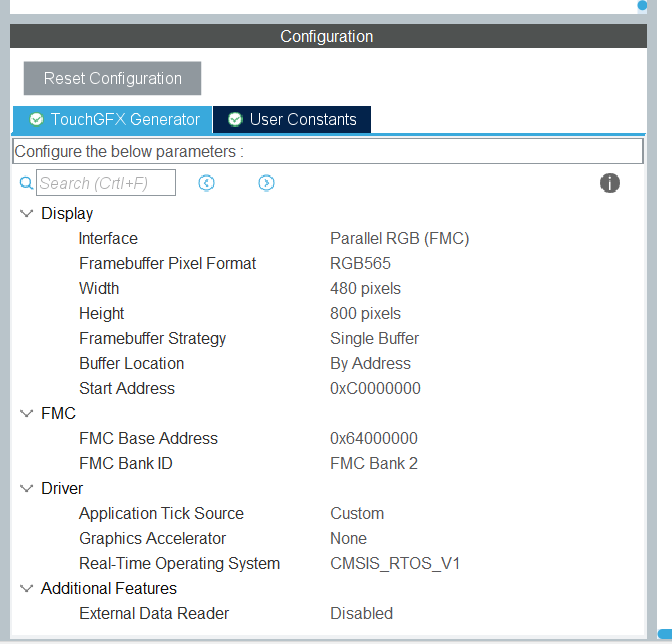

MX congiuration:

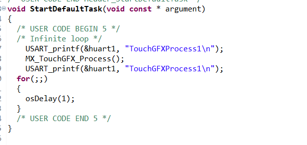

FreeRTOS task:

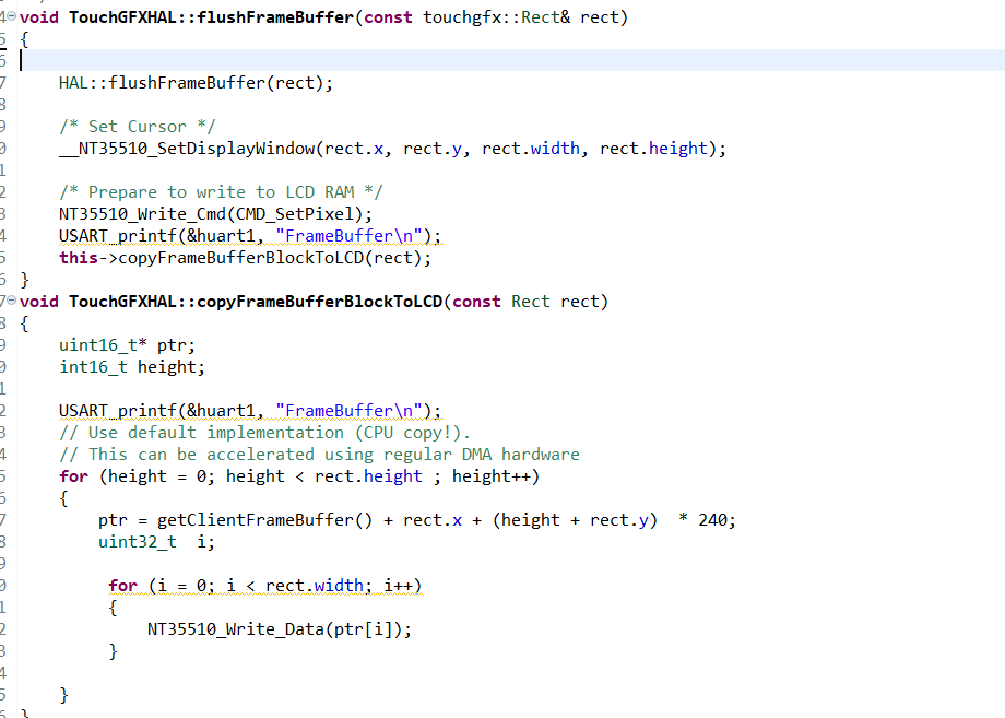

XHAL:

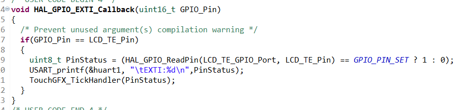

because my custom board not have the Tearing Effect PIN,so I connectec a 10Hz square wave
when the Semaphore is released.the os is blocking
