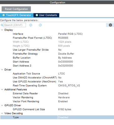

Below I am including photos of how I configured it on CubeMX.
In fact I am in the situation where it is called once return HALGPU2D::beginFrame(); and then that is it, the code runs but does not give errors. It stays in “loop” in prvIdleTask. It does not flush (HALGPU2D::flushFrameBuffer(rect);) or even HALGPU2D::endFrame();
I don't understand how I can move, following the example codes in Demo ST it all looks “identical”.
The thing I find strange is that by enabling only DMA2D in the Middleware->TouchGFX section all my (already quite advanced) graphics work perfectly without bugs (except for a slight slowness in some situations)
Is there something I am missing to properly enable GPU2D on my micro? Besides the configuration on CubeMX?

XCubeTouchGFX.png :
Here you have not enabled DMA2D, only GPU2D.
When you enabled GPU2D, did you disabled DMA2D in the process?
You can enable both at the same time, perhaps this is what you should do.
Here is the configuration for the STM32H7S7 TBS:
Regards,

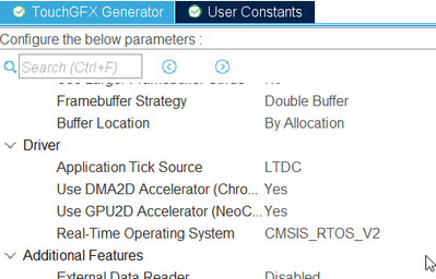

2025-03-13 7:37 AM
Hello @GaetanGodart ,
Thanks for your reply. Yes, I've already tried that solution, both DMA2D and GPU2D but it didn't work.
The result of the debug is the same unfortunately.
The only working solution is enabling the DMA2D and no GPU2D, but I need that.
Any other suggestion?

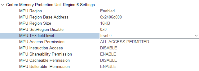

Have you enabled "ICACHE_GPU2D" under System core in CubeMX as well? It should be set to 2-way set associate.
The GPU2D command list is linked to the section
RAM_CMD (rw) : ORIGIN = 0x2406e000, LENGTH = 0x00004000The TouchGFX board setup uses these values:
RAM_CMD (rw) : ORIGIN = 0x2406c000, LENGTH = 0x00006000If you have the memory to spare, I would suggest trying to match that. In any case, you should set up an MPU region to cover the memory area as shown in the screenshot.
2025-03-28 5:17 AM
Hi @mathiasmarkussen , thank you very much.
Well, with this MPU configuration the "white page" problem is gone. My graphic now is "running".
