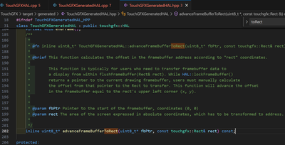

2025-03-04 1:46 AM - edited 2025-03-04 1:48 AM
>What do you have in your project?
Maybe there is a difference in the STM32F7 library?
TouchGFXGeneratedHAL.cpp:
inline uint8_t* TouchGFXGeneratedHAL::advanceFrameBufferToRect(uint8_t* fbPtr, const touchgfx::Rect& rect) const
// Advance vertically Advance horizontally
fbPtr += rect.y * lcd().framebufferStride() + rect.x * 2;
return fbPtr;
TouchGFXGeneratedHAL.hpp:
* @fn inline uint8_t* TouchGFXGeneratedHAL::advanceFrameBufferToRect(uint8_t* fbPtr, const touchgfx::Rect& rect) const;
* @brief This function calculates the offset in the framebuffer address according to "rect" coordinates.
* This function is typically for users who need to transfer framebuffer data to
* a display from within flushFrameBuffer(Rect& rect). While HAL::lockFrameBuffer()
* returns a pointer to the current drawing framebuffer, users must manually calculate
* the offset from that pointer to the Rect to transfer. This function will advance the offset
* in the framebuffer equal to the rect's upper left corner (x, y).
* fbPtr Pointer to the start of the framebuffer, coordinates (0, 0)
* rect The area of the screen expressed in absolute coordinates, which has to be transformed to address.
inline uint8_t* advanceFrameBufferToRect(uint8_t* fbPtr, const touchgfx::Rect& rect) const;
