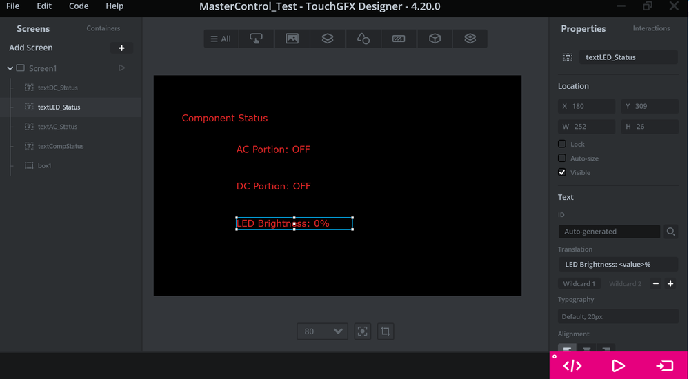

I am running a TouchGFX compiled code and am attempting to display a value from my code onto the LCD screen. I used the Tutorial 2 format for using the Unicode:snprintf function, but I am getting an error.
"TEXTLED_STATUS_SIZE" was not declared in this scope.
"textLED_StatusBuffer" was not declared in this scope.
I have included a screenshot of my TouchGFX Designer properties, showing that the name textLED_Status is correct.
Additionally, I have included the snippet of my code:

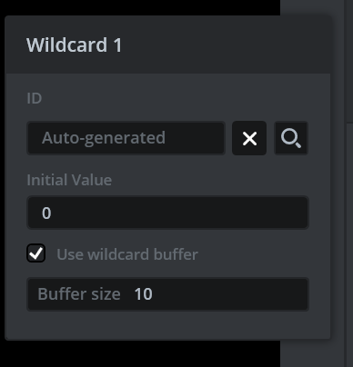

I spent an hour trying to debug this then found the source minutes after posting.... :)
In the TouchGFX designer, I did not have the "Use Wildcard Buffer" checkmarked. Did that and it resolved the issue.
