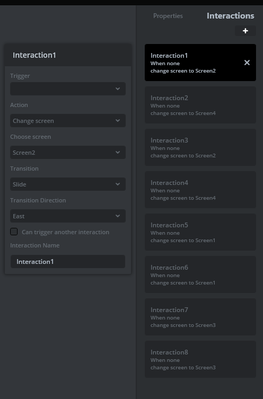

You can easily get all transition functions generated to FrontendApplicationBase.cpp by just adding empty interactions to some of your screens like
Remember to add all necessary transitions. Then you can trigger a transition from view by calling function like:
application().gotoScreen2ScreenSlideTransitionEast();Here is example of simple horizontal swipe detection. view.cpp:

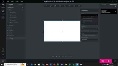

2024-05-28 10:24 PM - edited 2024-05-28 10:27 PM
Is this available in the latest TouchGFX version? we are using 4.21.00
How the trigger is detected i.e user has performed slide from top to bottom or right to left?. Can this be done using the touchGFX designer itself using interaction section or we need to write code?
Please see attached image
Thanks
Anuj

2024-05-29 12:04 PM
Hello Anuj
I think you must implement handleDragEvent-function to all screens for handle the draggings and then trigger slide transition from screen to another when needed.
