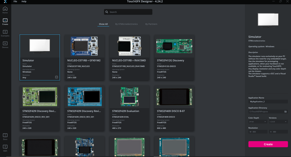

I created a new project I didn't even choose a board I tried it with the "Simulator"

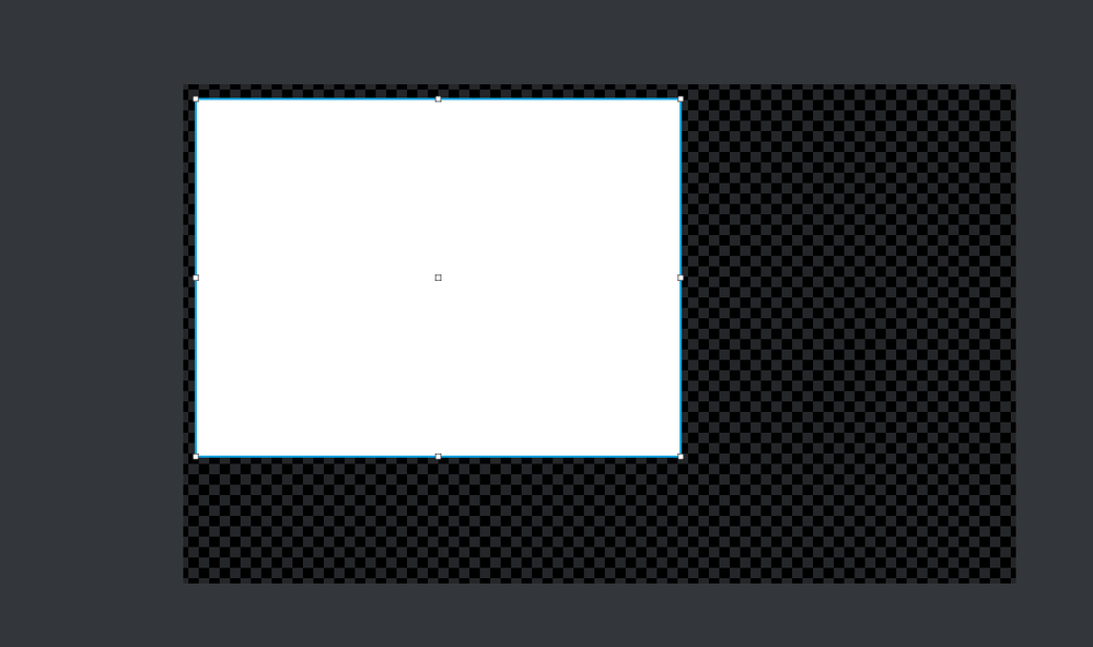

I want to try some ui designs in TouchGFX. I created a new project in Simulator type:
I just added a white box:

Of course. I want to try some ui designs in TouchGFX. I created a new project in Simulator type:

1. i created project : i selected simulator and clicked on creat button.

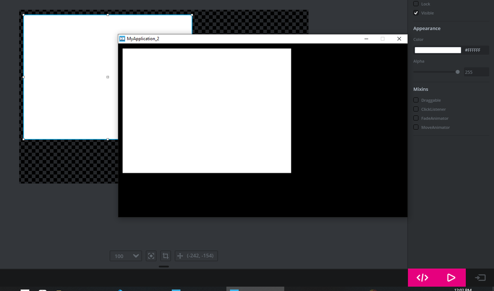

3. i generated and clicked on run simulator button. and then simulator screen popuped:
so this way you can simulate GUI on touchgfx. on clicking on RUN button you wont get any kindof exe file.

Works fine here with version 4.24.1 in Windows 11.
Project runs in popup.
It also creates an exe file: C:\TouchGFXProjects\community_test\build\bin\simulator.exe
