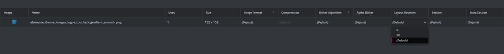

You also don't need to rotate your pictures manually, just need to set their rotation from the Images tab in TouchGFX.
Rotation of Images

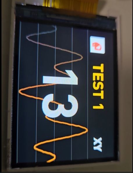

Now almost everything works perfect. In landscape mode everything is perfect.

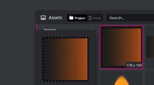

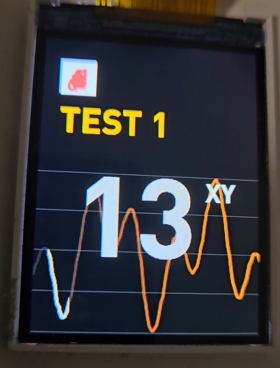

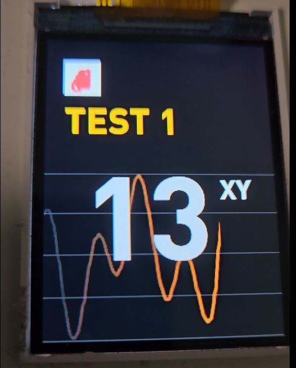

But when we rotate screen for 90 degrees (portrait mode) my dynamic graph is not OK (the part of the line graph at the beginning is white). For graph line we used rotated image (240*170) and there is no white spots in the image.
Image for GraphLine!
If we use smaller image (180*170) for graph line the graph works perfect (but no line in the end). Or if we remove some images or texts from our animation, then graph is working OK.
Also if we use just color for graph line (not image), all graphs work perfect!
Any suggestion? Memory problem? Buffers? we changed the size of some buffers for TouchGFX but there was no improvement (Memory Pool size, memory stack size for TouchGFX).
