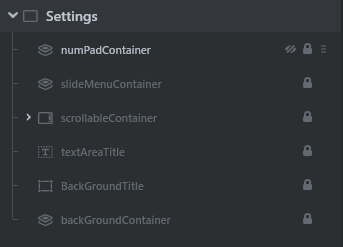

I build a custom Numpad Container. Iam setting it Visible when a textarea is clicked. And it is the top layer on the Screen. Trying to set other containers on a lower layer not touchable is not working.
I can still click the slide menu button und some other buttons on my Background container.
Is it a bug?
scrollableContainer.setTouchable(false);
slideMenuContainer.setTouchable(false);
backGroundContainer.setTouchable(false);

Mz goal is to block all other inputs on the display. In the back there is a background container with a button to switch the language, set the time and some other buttons. I tried to block these buttons with the function setTouchable(false) and invalidate();. But this worked not for all the buttons in the background container. So i tried to block the touch input for the container.
