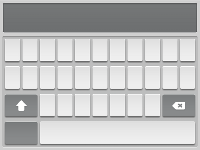

I am trying to use the CustomKeyboard provided in TouchGfx for a STM32F769 discovery board (https://www.st.com/en/evaluation-tools/32f769idiscovery.html).
How can i resize the keyboard? Is this possible without resizing each key individually?
The keyboard seems to have a predefined size of 320x240 which is to small for my board.
I tried using the provided methods (setPosition(), setWidth(), setHeight() with invalidate()) for setting the width and height, but it seems not to work as expected.
Do i need to resize any single key? How would i do that?

Yes unfortunately you need to change the layout itself entirely.
Basically, you need to change the values in the keyArray in KeyboardLayout.hpp. This also means you need new images for the keys since the size will be different.

Ill post here for anyone who is trying to do this in the future - it is not that bad, Ill go over how to make the changes in the example keyoard project. First go into KeyboardLayout.hpp and make the appropriate changes. I just doubled the size, so double the corresponding widths/heights/spacings. The rect() command goes: x, y, width, height. The file I modified is below:
#ifndef KEYBOARD_LAYOUT

#endifNext modify MainView.cpp and make the following changes so the height/width are set appropriately:

}You need to change not only the setPosition call on the keyboard/fix the height and width, but also change the position/height/width for the mode button as well, I missed this my first time around and my mode button was halfway up the screen. The last thing you need to do is create new keyboard recourses, which I did/just doubled the size of the original files, Ill attach those to this post. Just download and name the files the appropriate name and put them into the /assets/images directory.
2021-12-02 4:09 AM
Wow, big thanks from me. I'd also edited size, but scaled to 640 x 360

{22, Rect(KB_X_SHIFT + (KB_SYM_WIDTH + KB_SYM_X_SP) * 10, KB_Y_SHIFT + KB_SYM_Y_SP, KB_SYM_WIDTH, KB_SYM_HEIGHT), BITMAP_KEYBOARD_KEY_HIGHLIGHTED_ID},
{23, Rect(KB_X_SHIFT2, KB_Y_SHIFT + KB_SYM_Y_SP * 2, KB_SYM_WIDTH, KB_SYM_HEIGHT), BITMAP_KEYBOARD_KEY_HIGHLIGHTED_ID},
{24, Rect(KB_X_SHIFT2 + (KB_SYM_WIDTH + KB_SYM_X_SP), KB_Y_SHIFT + KB_SYM_Y_SP * 2, KB_SYM_WIDTH, KB_SYM_HEIGHT), BITMAP_KEYBOARD_KEY_HIGHLIGHTED_ID},
{25, Rect(KB_X_SHIFT2 + (KB_SYM_WIDTH + KB_SYM_X_SP) * 2, KB_Y_SHIFT + KB_SYM_Y_SP * 2, KB_SYM_WIDTH, KB_SYM_HEIGHT), BITMAP_KEYBOARD_KEY_HIGHLIGHTED_ID},
{26, Rect(KB_X_SHIFT2 + (KB_SYM_WIDTH + KB_SYM_X_SP) * 3, KB_Y_SHIFT + KB_SYM_Y_SP * 2, KB_SYM_WIDTH, KB_SYM_HEIGHT), BITMAP_KEYBOARD_KEY_HIGHLIGHTED_ID},
{27, Rect(KB_X_SHIFT2 + (KB_SYM_WIDTH + KB_SYM_X_SP) * 4, KB_Y_SHIFT + KB_SYM_Y_SP * 2, KB_SYM_WIDTH, KB_SYM_HEIGHT), BITMAP_KEYBOARD_KEY_HIGHLIGHTED_ID},
{28, Rect(KB_X_SHIFT2 + (KB_SYM_WIDTH + KB_SYM_X_SP) * 5, KB_Y_SHIFT + KB_SYM_Y_SP * 2, KB_SYM_WIDTH, KB_SYM_HEIGHT), BITMAP_KEYBOARD_KEY_HIGHLIGHTED_ID},
{29, Rect(KB_X_SHIFT2 + (KB_SYM_WIDTH + KB_SYM_X_SP) * 6, KB_Y_SHIFT + KB_SYM_Y_SP * 2, KB_SYM_WIDTH, KB_SYM_HEIGHT), BITMAP_KEYBOARD_KEY_HIGHLIGHTED_ID},
{30, Rect(KB_X_SHIFT2 - 2, KB_Y_SHIFT + KB_SYM_Y_SP * 3, KB_SP_WIDTH, KB_SYM_HEIGHT), BITMAP_KEYBOARD_SPACE_HIGHLIGHTED_ID}
* Callback areas for the special buttons on the CustomKeyboard.
static Keyboard::CallbackArea callbackAreas[3] =
{Rect(KB_X_SHIFT, 223, 112, KB_SYM_HEIGHT), 0, BITMAP_KEYBOARD_KEY_SHIFT_HIGHLIGHTED_ID}, // caps-lock
{Rect(516, 223, 112, KB_SYM_HEIGHT), 0, BITMAP_KEYBOARD_KEY_DELETE_HIGHLIGHTED_ID}, // backspace
{Rect(KB_X_SHIFT, KB_Y_SHIFT + KB_SYM_Y_SP * 3, 112, KB_SYM_HEIGHT), 0, BITMAP_KEYBOARD_KEY_NUM_HIGHLIGHTED_ID}, // mode
* The layout for the CustomKeyboard.
static const Keyboard::Layout layout =
BITMAP_KEYBOARD_BACKGROUND_ID,
keyArray,
30,
callbackAreas,
3,
Rect(30, 15, 11 * (KB_SYM_WIDTH + KB_SYM_X_SP), KB_SYM_HEIGHT),
TypedText(T_ENTEREDTEXT),
#if !defined(USE_BPP) || USE_BPP==16
0xFFFF,
#elif USE_BPP==24
0xFFFFFF,
#elif USE_BPP==8
0xFF,
#elif USE_BPP==4
0xF,
#elif USE_BPP==2
0x3,
#else
#error Unknown USE_BPP
#endif
Typography::KEYBOARD,
0
#endif
