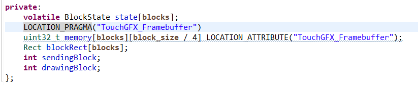

I have already read the links that you sent, but the difference with partial framebuffers is that partial ones are not simply stored as a single variable. The function that constructs the buffer is defined in the FrameBufferAllocator.hpp file and I cannot find a way to use LOCATION_PRAGMA for instance to set the location that the buffers are stored.
I tried to put the LOCATION_PRAGMA there but I had no luck and encountered this error: "section attribute not allowed for 'memory' "
