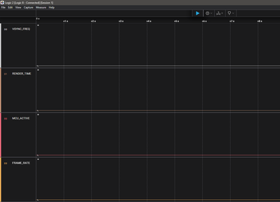

2025-04-03 12:01 PM
This issue is still unresolved.
I tested this with:
STM32CubeIDE v1.18.0
TouchGFX v4.25
Firmware Package STM32Cube FW_H7 V1.12.1
All 4 signals stay low:
@Mohammad MORADI ESFAHANIASLany ideas?
