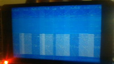

2024-03-22 5:11 AM - edited 2024-03-22 5:14 AM
In an attempt to improve performance, I've followed this guide: Changing the Pixel Format of an Application | TouchGFX Documentation to change the pixel format from RGB888 to RGB565. I've also called:
The changes resulted in this beeing display:
Any guidance on how to change the pixel format?
My experience is similar to what is described in this thread: STM32H747I-DISCO 16-bit Color Depth Problem - STMicroelectronics Community

Also, I can confirm that changing the pixel format results in an invalid framebuffer. I will spend some time on it and get back to you with a conclusion.
