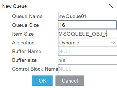

And for the queue you would set it up like this
Hope that helps.
