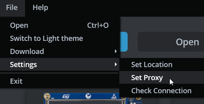

Hello @DominikBiscette ,
Do you have a red triangle at the top of your TouchGFX Designer?
You can fix that in "File" => "Settings" => "Set proxy":
Regards,

I have checked it but the firewall is not blocking it. And I do not use a proxy. But even if I choos no proxy at the setting the connection fails.
