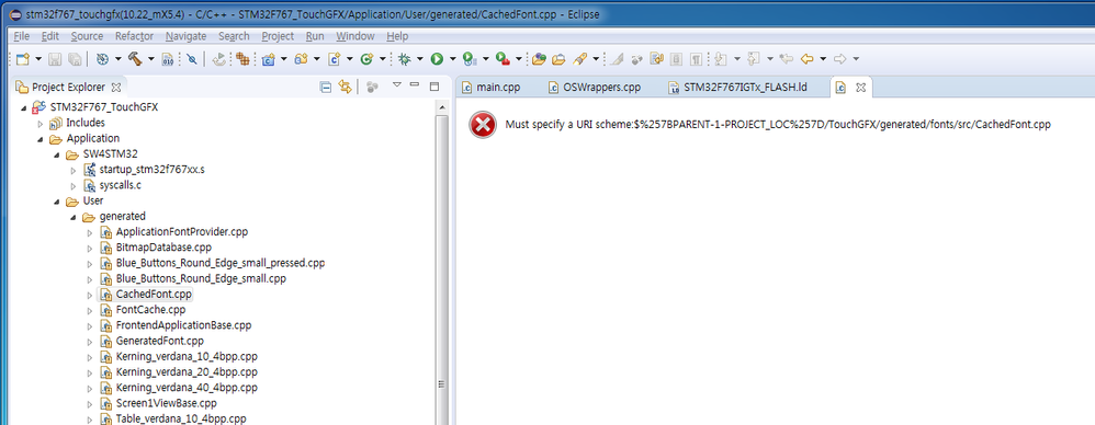

I have a similar problem.
There is nothing wrong with building with cubeMX 5.3.
However, building with cubeMX 5.4 and TouchGFX 4.12.3 caused the following problems.
