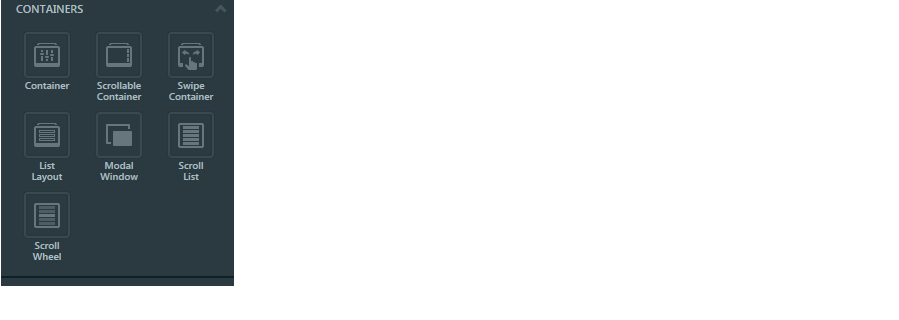

Which Widget should I use ..

Scroll Wheel - It has a "selected item" in the center. Read the doc about it at support.touchgfx.com.

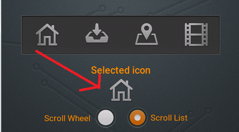

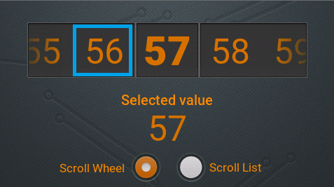

Thanks for link . I have read and run demo "Scroll Wheel and Scroll List " as below:
1) Is it possible to "Highlight " Selected any item on click ,rather than center ?
2) Can I use <Fwd> <Rev> Button for Scrolling ?
