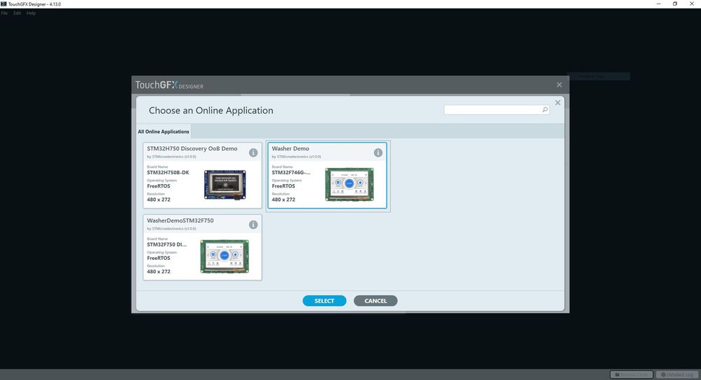

Hello Martin,
I have installed TouchGFX 4.13 and I am not able to see the V3.0 templates in the online applications.
Where can I see the V3.0 templates?
Thanks,
Tushar
2020-01-23 11:26 AM
Sorry Martin, I forget to change the board from Simulator to specific boards. After Changing to Specific boards I am able to see v3.0.0 templates
2020-01-23 1:03 PM
That's quite allright :) Glad you figured it out @tushar_tp
