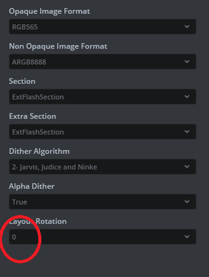

One more idea, what about this setting, it must be 0. It seems mix images wierdly if 90.
Maybe its worth testing put some box etc to tgfx also.

Yes, using both the portrait or landscape option under Display Orientation will also change the Layout Rotation, and using both versions as shown in my first images produces the same output image.

To get the images to show properly on the display I also had to change the Layout Rotation from 90 to 0 in the TouchGFX designer:
config -> Default Image Configuration -> Layout Rotation.
