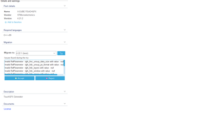

i update touchgfx via cubeMX which gives me some errors(don't know if it is important)
i open my touchgfx project in designer 4.22.1 and regenrate *booom* files are deleted and not regenerated

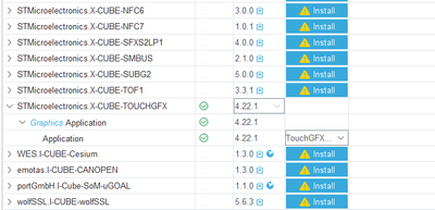

Is it possible to try installing the new version (TouchGFX 4.22.1) manually from CubeMX -> Help -> Manage Embedded Software Packages, then under the STMicroelectronics tab, X-CUBE-TOUCHGFX section ?
After installing, open your project, then go to Software Packs -> Select Components and make sure the version 4.22.1 is selected.
And of course make sure you have a backup before applying these changes.
Good luck
2023-10-31 8:53 AM
ok, the version was selected. But i did not notice the settings for touchgfx itself (resolution, pixel mode etc) were not set. After setting these again the files are generated.
