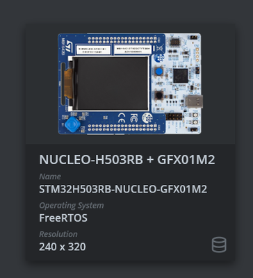

You can look at some of our TBS (TouchGFX Board Setup) such as the ones using the GFX01 display that are not touch and therefore use a joystick to interface :
