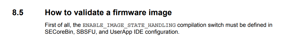

I have followed https://www.st.com/resource/en/application_note/an5056-integration-guide-for-the-xcubesbsfu-stm32cube-expansion-package-stmicroelectronics.pdf (Chapter 8.5)

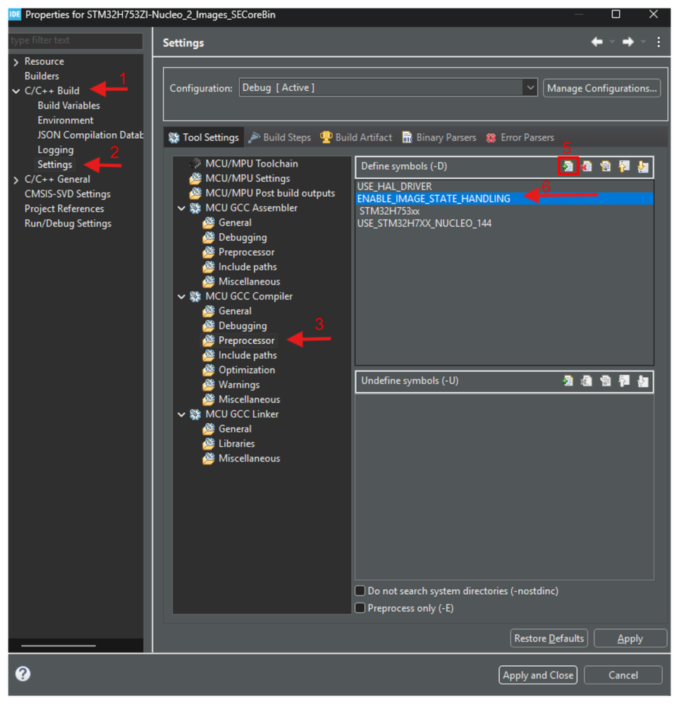

As per said in the AN5056 (Chapter 8.5)
you need to enable the FLAG in the 3 projects:
ENABLE_IMAGE_STATE_HANDLING
To do so, Go into each project (SECoreBin, SBSFU, UserApp) and follow these steps:
- Right click and then properties and follow the instructions below as set in the picture below:
Then click apply and close.
Then do a clean and rebuild of all projects.
