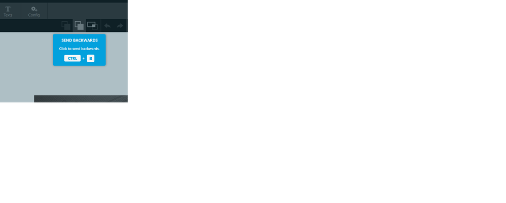

We have figured out solution for Problem 1 as well.!
Need to send the graph back to one screen and make that screen transparent. That will still show the page layout as you have designed with graph but it will not allow you to generate graph swipe event. But works well for swiping even in graph screen.
2021-03-19 8:40 AM
Hi Syann.1,
Thanks for answering.
What do you mean by "send the graph back to one screen"?
2021-03-19 10:16 PM
Hi Franck23,
there is way in touchgfx designer to bring widgets front and back.
2021-03-20 8:18 AM
When you say "send the graph back to one screen", do you mean to get the graph directly on the screen, behind the swipe container, so that the graph is not part of the swipe container anymore?
It would work for just one graph.
However, I have 2 graphs to swipe so I would still need to have one graph inside a swipe page.
