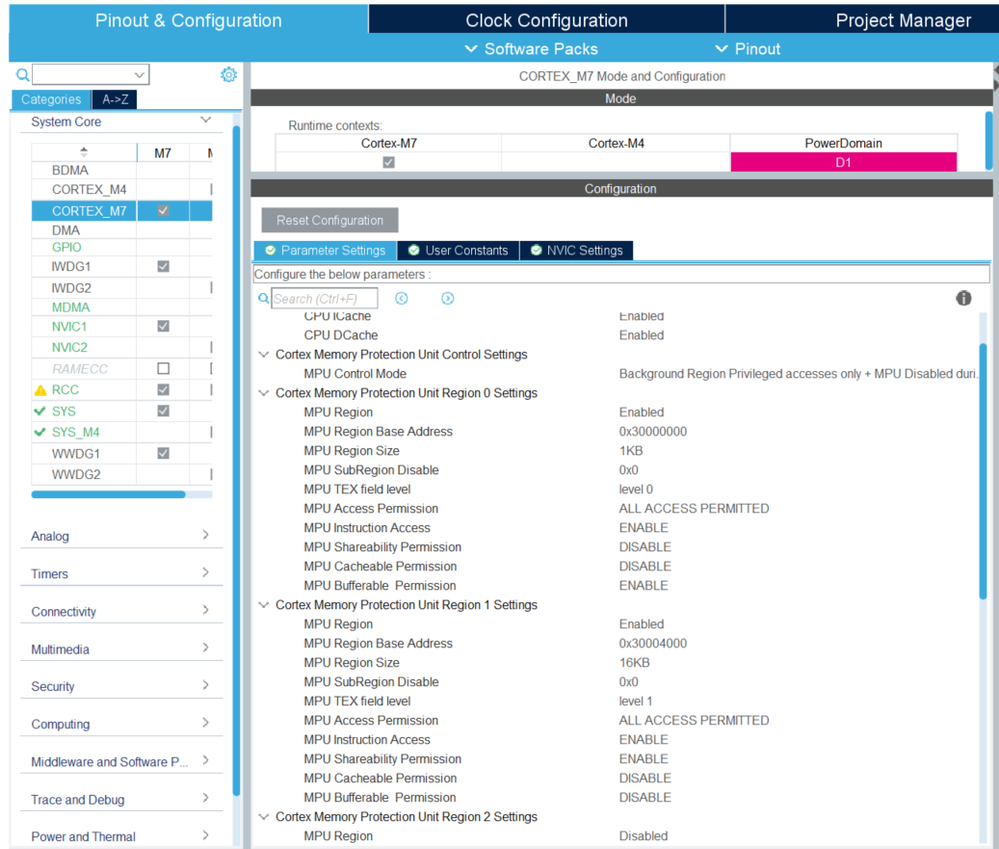

1) Configuring MPU regions like this:

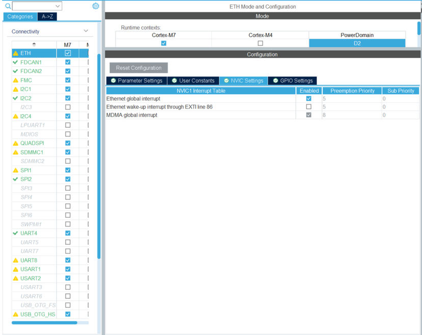

2) After that I have enable the global interrupt for ETH peripheral like this:

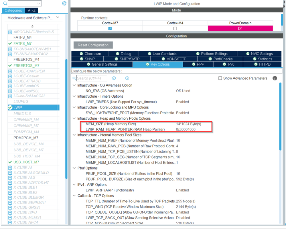

3) Subsequently in Middleware section I have enabled the LwIP, set the platform and changed only MEM_SIZE and HEAP_POINTER like this:
while I have disabled the DHCP and set my static IP Address.
