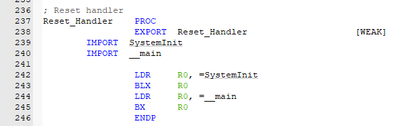

In startup file startup_stm32h757xx.s
execution up to line-245 is OK, jump to main() in application happens after pressing RUN tab multiple times in debug mode. Once execution reach main function then screen display & font all are fine.
FYI, we are using CM7 & CM4 core. use external flash QSPI & external SDRAM. Entire application was running smooth with 4.21.3 only issue we faced with fonts.

This looks like semi-hosting issue. Which IDE are you using?
2025-10-09 2:17 AM - edited 2025-10-09 2:17 AM
Could be a cache issue. If you use cache do you flush your cache? You can try disabling cache.
Could also be a missing invalidate() call.
