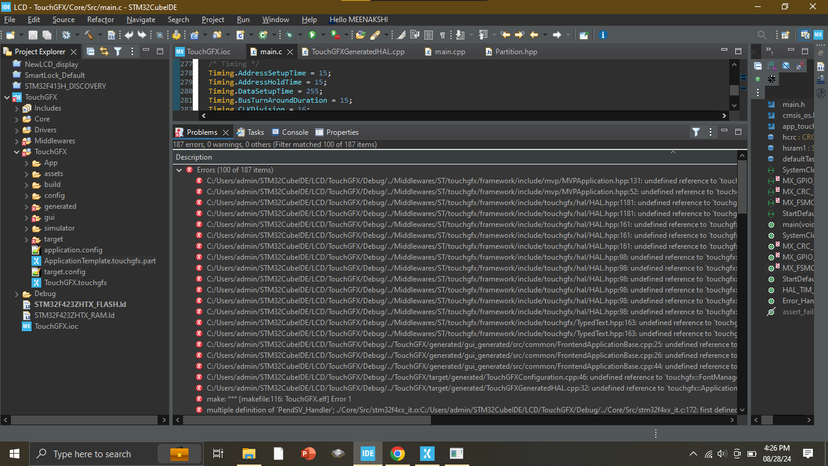

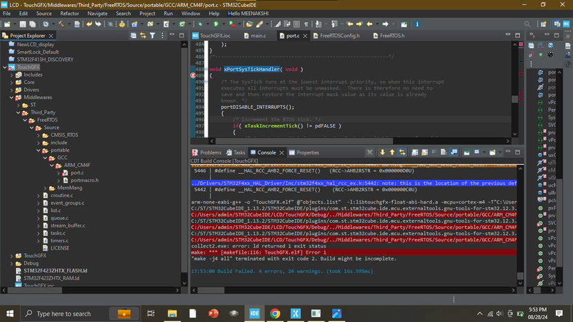

I'm using STM32F423ZHT6 board.

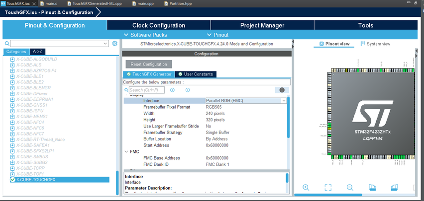

I setup the X-CUBE-TOUCHGFX

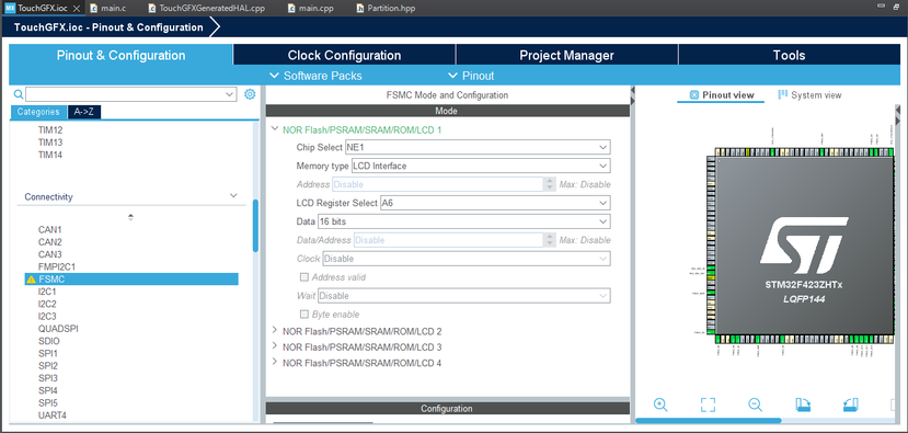

And FSMC for LCD interface:
After generate a code. I opened TouchGFX -> ApplicationTemplate.touchgfx.part.
In TouchGFX, I created a boxWithBorder
Then Generate code. After Build my project, It shows 187 errors.
Please any one help me to done a project?
If I made mistake correct me :smiling_face_with_smiling_eyes:
Regards,
Mee

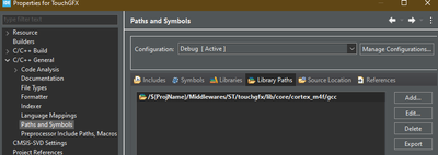

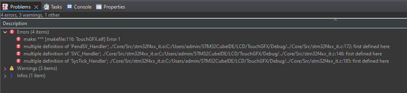

2024-08-28 5:25 AM

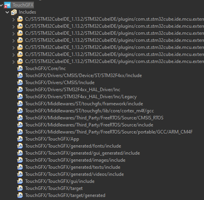

Thanks for your reply @LouisB. I solved the max errors with the help of https://community.st.com/t5/stm32-mcus-touchgfx-and-gui/how-to-solve-undefined-reference-errors-during-building-a/td-p/98276
But still I got some errors:

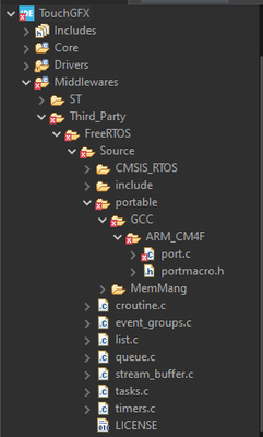

There are my includes
2024-08-28 5:31 AM

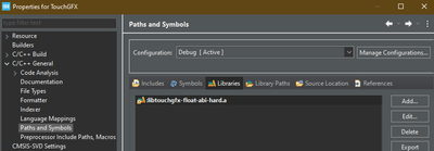

Can you try this Solved: Cannot use TouchGFX with STM32CubeIDE (undefined r... - STMicroelectronics Community, use @Mohammad MORADI ESFAHANIASL solution.
2024-08-28 9:48 PM
Hi @LouisB
I try this Solved: Cannot use TouchGFX with STM32CubeIDE (undefined r... - STMicroelectronics Community,
But, still I got the same error
