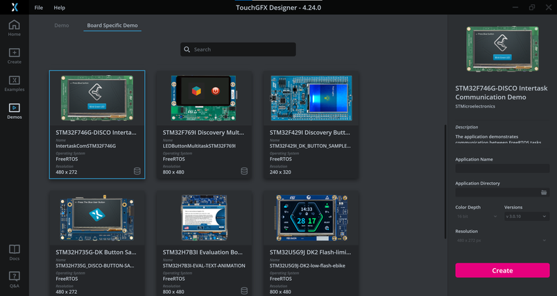

Hello @Oussama_Baklouti,
As @mƎALLEm mentioned, there are no custom code for the sendData() function that you have defined for your button. Please refer to the following documentations to learn about communication of TouchGFX with backend.
You can also take a look at the Board Specific Demos available in the TouchGFX Designer, like STM32F746G-Disco Intertask Communication Demo
STM32F476G-Disco Board Specific Demo
I hope this helps you!

2024-08-29 6:29 AM
