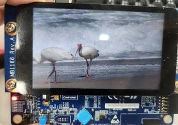

I am using the TouchGFX video widget to play custom videos on the STM32H747I-DISCO development board. I am able to play videos by placing them in the assets/videos folder and modifying Screen1View.cpp as described in the MJPEG Video . The video playback works as expected on this board, as shown in the the image below.

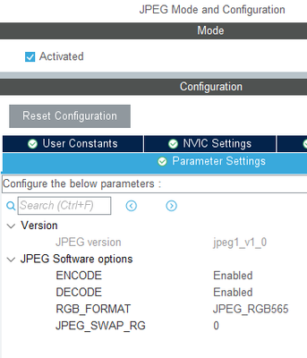

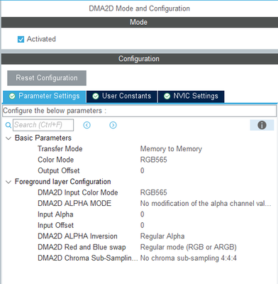

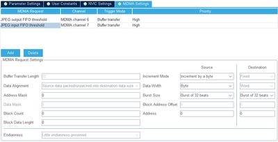

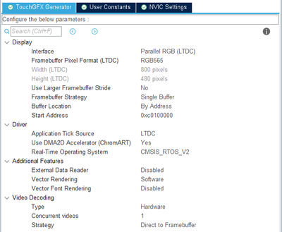

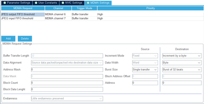

I followed the steps and am using a custom development board with the MCU STM32H743BGTx.
The TouchGFX framebuffer is set to single buffer, and video decoding is set to hardware/direct to framebuffer, so there is no need to create a videoTaskFunc() in the RTOS.
This setting works with the Riverdi-RVT101HVSNWC00-B, but it doesn't work on the custom development board. Strangely, if I set video decoding to "Disable," the TouchGFX screen displays correctly on the monitor. However, when set to "Hardware," the screen turns completely black.How can I do to my custom development board?
TouchGFX setting
