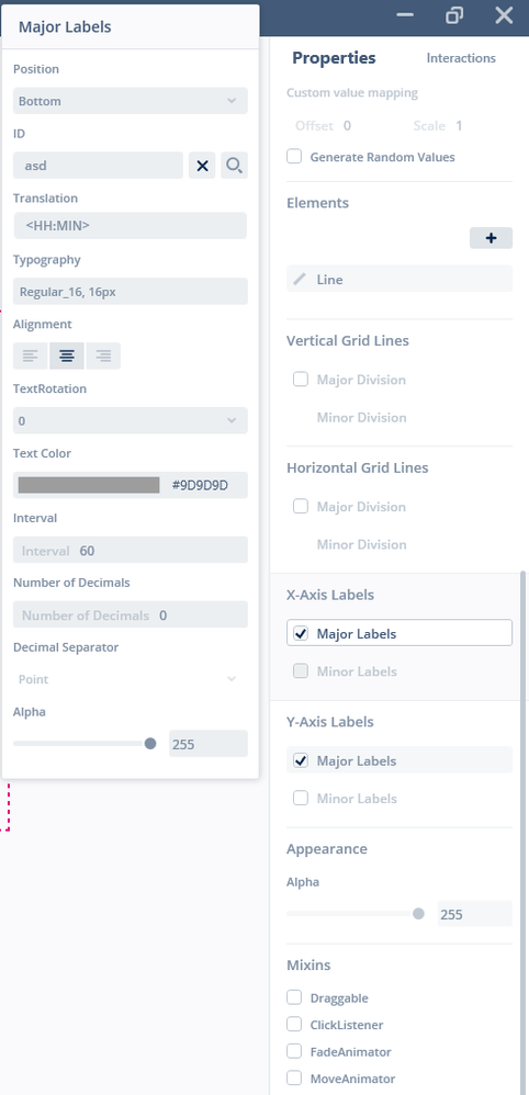

I am trying to use the existing dynamic graph in such a way, that the x-axis labels are using a timestamp rather than a simple incrementing number. This is what I currently have:

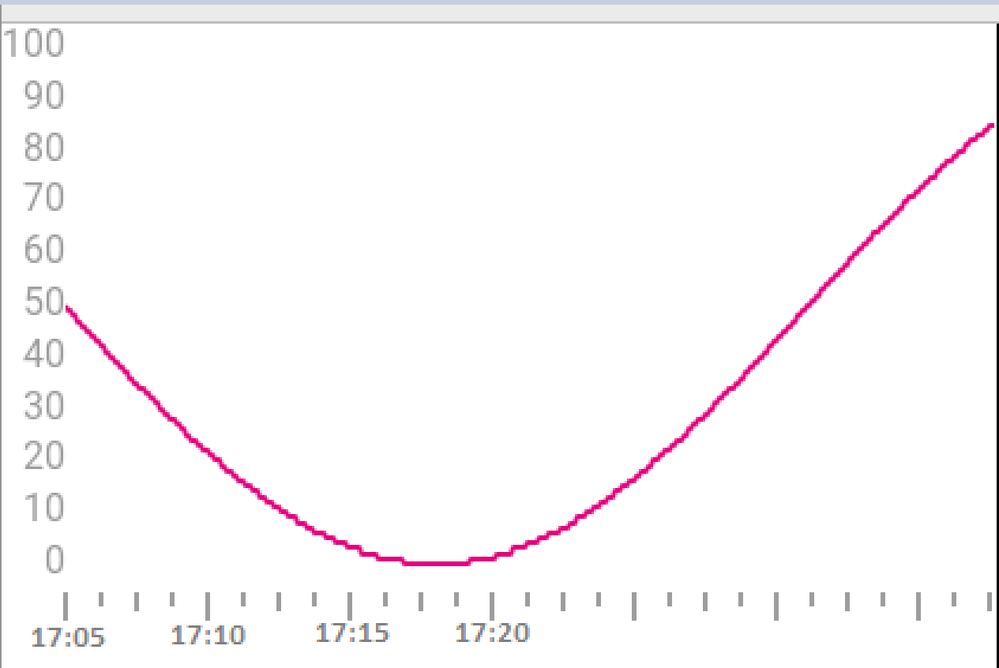

And this is what I need:
I guess I haven't fully understood the concept of wildcards, but this is currently the settings I have:
Any hint is highly appreciated as I found several posts like this in this forum but none of them got answered properly, so I hope that this post would clarify how to properly use the X-Axis Labels

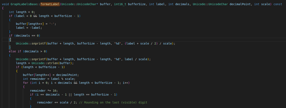

I probably found the place where the formatting of the Axis is done:
But due to the fact, that the "formatLabel" method is not virtual, it seems that using the existing widget will no work for me, correct?
