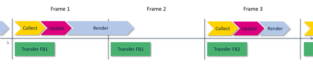

I'm a bit confused about the strategy used to determine when to swap buffers when TouchGFX is configured for double frame buffers. As illustrated here, the intent of the double frame buffer is to allow the old frame buffer to be presented if there is a long render time for the next frame. The issue is that I don't see how the TouchGFX implementation enables this. My understanding is that the function HAL::swapFrameBuffers is responsible for switching the pointer to the current frame buffer for the LTDC. Looking at calls to this function, the only one I can find is within the HAL_LTDC_LineEventCallback within TouchGFXGeneratedHAL.cpp.

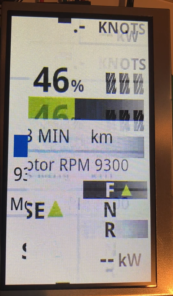

}My current suspicion is that it's something with the LTDC. If I put a break point in the TouchGFXHAL::endFrame() function I can step through the generation of each frame. The artifacts I am seeing are not corruptions in the frame buffer because they appear and go away while the processor is halted. The artifact seems to be a shift up in the pixels along with dropping/shifting the RGB channels. The affected area seems to progress from the right side of the screen to the left.
See the video below. There is a counter in the Model::tick() function that is setting the "<value> MIN" field below the blue bar. This can be used to see when frames are generated (I hit continue from the TouchGFXHAL::endFrame() breakpoint). Around 29s when the counter gets to 94 the image is distorted but is corrected on the next refresh without the memory being touched (no new frame generated/inverted). When the count gets to 128 I take out the break point and let the program continue so you can see the distortion in real-time.

Can you tell me what's supposed to be there where the artifcats are? Something tells me they're images and you haven't programmet those images to flash. This does not really seem like a buffering-run-time-gitch-kind-of-issue. It's a pretty quiet application.
/Martin
2020-11-19 9:22 AM
I'm sorry, the issue that I'm chasing in this post does not have to do with those images. They are supposed to be small icons generated from .png files, but I'm not sure why they're not working. I should have just removed them before taking the video. I haven't started troubleshooting that yet.
The artifacts I'm referring to for this issue are the flashing and shifts of the frame. Here is a screenshot of the video around 29s:

I was able to (hopefully) resolve the issue today. After some messing with the LTDC and enabling the error interrupts I found that the FIFO buffer in the LTDC is experiencing buffer underruns. In my application (STMH753) the frame buffers are held in a 8MB external SRAM. All of my program RAM is currently configured in the 512KB SRAM. Both of these peripherals are on the 64-bit AXI bus. Looking at my linker script, my .bss and .data sections were not properly aligned to 64 bit. Taking out the . = ALIGN(4); or . = ALIGN(8); statements and replacing them with . = ALIGN(64); statements seems to have cleared up the issue for now.
I don't have the deepest understanding of why this helps. I know it's not efficient to access smaller addressed variables on the 64 bit bus, but this just adjusts the location of the entire data block, not necessarily the variables within the block. I would think the push/pop operations on the various stacks for the tasks would be causing the bandwidth issues, and they are happening somewhere randomly in the middle of the section of RAM.
