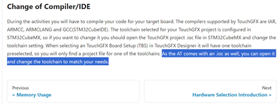

Muharrem
Associate III
Hello.
https://support.touchgfx.com/docs/development/development-introduction
Last words of this section:
"As the AT comes with an .ioc as well, you can open it and change the toolchain to match your needs."
What is AT?
