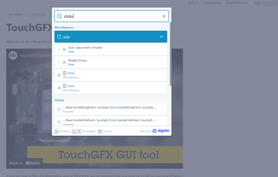

ferro
Lead
Hi Gfx team,
When I type 'slider' into the search, could the returned list start with a link to the Slider classs API please ?
https://support.touchgfx.com/docs/api/classes/classtouchgfx_1_1_slider
At the moment, the list gives many other references. These are of course very useful, but I see a class API as a candidate for the top position. In this particular case i.e. Slider, link to its class API is not even in the list.
https://support.touchgfx.com/search?q=slider
Thank you.
Best regards,
Ferro

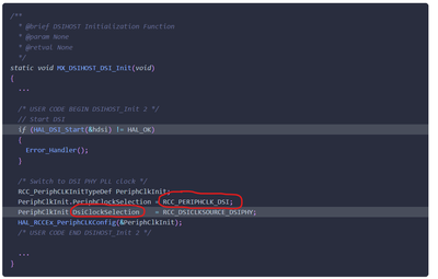

RobNewbury
Senior
I am following the TouchGFX documentation to help me implement a video mode DSI LCD display connected to the STM32F469I-Disco board (built in display is disconnected, new display connected via an adaptor board).
The following section of the TouchGFX documentation relates to a video mode DSI interface.
I have configured and generated code using STM32CubeMX as described in the documentation (altered to account for my display characteristics such as resolution, front and back porches etc.)
Some code has to be added manually in a User Code section in order to switch the DSIHOST clock to the DSIPHY source during initialisation as described in the documeatation under the heading 'DSIHOST / LTDC Initialization sequence'
The code shown refers to RCC_PERIPHERAL_DSI which neither the compiler nor I am able to find. I expected it to be in stm32f4xx_hal_rcc.h or stm32f4xx_hal_rcc_ex.h but I don't see it in either file.
Also the compiler reports that PeriphClkInit.DsiClockSelection is not a valid member of RCC_PeriphCLKInitTypeDef
Without this code implemented the DSI clock is not running so I think it is essential.
It would be useful if the documentation made clear which include files are required to support the code.
I believe the documentation is wrong or out of date so I am not sure now how to procede.
