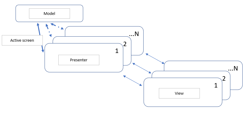

I started to use TouchGFX few days ago and it took me a while to understand that there is only 1 Model for the whole GFX (I come from Qt world so had to readjust to GFX's use of Model concept). I think it would help a lot if this was emphasized in docementation a bit more eg:

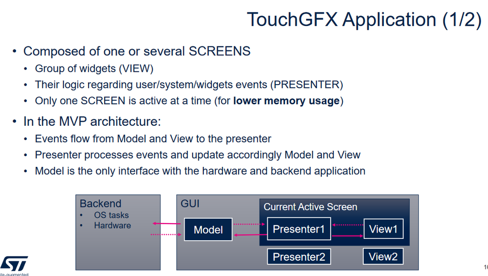

Or as it is done in this document:
www(dot)e4ds(dot)com/prom/files/Quest_5_Material.pdf
