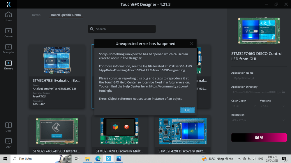

last time also this problem was occured so I installed it again after that it run for some days now again the problem has occured.
When I open Touchgfx one msg come
Sorry - something unexpected has happened which caused an error to occur in the Designer.
For more information, see the log file located at: C:\Users\Kaushal\AppData\Roaming\TouchGFX-4.21.3\TouchGFXDesigner.log
Please someone help to give the solution of it.

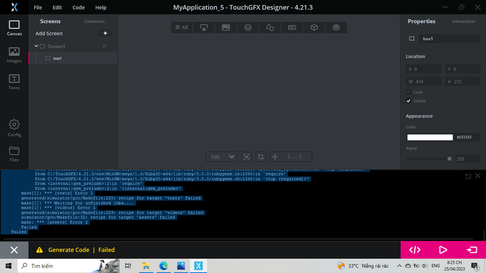

2023-04-25 6:26 AM - edited 2023-11-20 9:05 AM
i have same problem with u
when i using demo
when i trying Generate Code, run simulator and run target has same this error
Generate Code
Copy Framework
Copying TouchGFX framework version 4.21.3 to C:\Users\GIANG\Documents\TOUCH_GFX\MyApplication_5\Middlewares\ST\touchgfx
Done
Generate
Wrote config/gcc/app.mk
Wrote config/msvs/Application.props
Wrote generated/gui_generated/include/gui_generated/common/FrontendApplicationBase.hpp
Wrote generated/gui_generated/include/gui_generated/common/FrontendHeapBase.hpp
Wrote generated/gui_generated/include/gui_generated/common/SimConstants.hpp
Wrote generated/gui_generated/include/gui_generated/screen1_screen/Screen1ViewBase.hpp
Wrote generated/gui_generated/src/common/FrontendApplicationBase.cpp
Wrote generated/gui_generated/src/screen1_screen/Screen1ViewBase.cpp
Wrote generated/simulator/gcc/Makefile
Wrote generated/simulator/include/simulator/mainBase.hpp
Wrote generated/simulator/include/simulator/video/DirectFrameBufferVideoController.hpp
Wrote generated/simulator/include/simulator/video/MJPEGDecoder.hpp
Wrote generated/simulator/include/simulator/video/SoftwareMJPEGDecoder.hpp
Wrote generated/simulator/msvs/touchgfx_prebuild.targets
Wrote generated/simulator/msvs/touchgfx_sdl2.props
Wrote generated/simulator/msvs/touchgfx.props
Wrote generated/simulator/src/mainBase.cpp
Wrote generated/simulator/src/video/SoftwareMJPEGDecoder.cpp
Wrote generated/simulator/touchgfx.ico
Wrote generated/simulator/touchgfx.rc
Wrote generated/simulator/touchgfx.res
Wrote generated/user.config
Wrote gui/include/gui/common/FrontendApplication.hpp
Wrote gui/include/gui/common/FrontendHeap.hpp
Wrote gui/include/gui/model/Model.hpp
Wrote gui/include/gui/model/ModelListener.hpp
Wrote gui/include/gui/screen1_screen/Screen1Presenter.hpp
Wrote gui/include/gui/screen1_screen/Screen1View.hpp
Wrote gui/src/common/FrontendApplication.cpp
Wrote gui/src/model/Model.cpp
Wrote gui/src/screen1_screen/Screen1Presenter.cpp
Wrote gui/src/screen1_screen/Screen1View.cpp
Wrote simulator/gcc/Makefile
Wrote simulator/main.cpp
Wrote simulator/msvs/Application.sln
Wrote simulator/msvs/Application.vcxproj
Wrote simulator/msvs/Application.vcxproj.filters
Wrote target.config
Done
Generate Assets
make -f simulator/gcc/Makefile assets -j8
Reading ./application.config
Reading ./target.config
Generating generated/images/include/BitmapDatabase.hpp
Generating generated/images/include/images/BitmapDatabase.hpp
Generating generated/images/src/BitmapDatabase.cpp
Generating generated/images/include/images/SVGDatabase.hpp
Generating generated/images/src/SVGDatabase.cpp
C:/TouchGFX/4.21.3/env/MinGW/msys/1.0/Ruby30-x64/lib/ruby/3.0.0/win32/registry.rb:910:in `encode': code converter not found (UTF-16LE to Windows-1258) (Encoding::ConverterNotFoundError)
from C:/TouchGFX/4.21.3/env/MinGW/msys/1.0/Ruby30-x64/lib/ruby/3.0.0/win32/registry.rb:910:in `export_string'
from C:/TouchGFX/4.21.3/env/MinGW/msys/1.0/Ruby30-x64/lib/ruby/3.0.0/win32/registry.rb:611:in `each_key'
from C:/TouchGFX/4.21.3/env/MinGW/msys/1.0/Ruby30-x64/lib/ruby/site_ruby/3.0.0/ruby_installer/runtime/msys2_installation.rb:62:in `block in iterate_msys_paths'
from C:/TouchGFX/4.21.3/env/MinGW/msys/1.0/Ruby30-x64/lib/ruby/3.0.0/win32/registry.rb:435:in `open'
from C:/TouchGFX/4.21.3/env/MinGW/msys/1.0/Ruby30-x64/lib/ruby/3.0.0/win32/registry.rb:542:in `open'
from C:/TouchGFX/4.21.3/env/MinGW/msys/1.0/Ruby30-x64/lib/ruby/site_ruby/3.0.0/ruby_installer/runtime/msys2_installation.rb:61:in `iterate_msys_paths'
from C:/TouchGFX/4.21.3/env/MinGW/msys/1.0/Ruby30-x64/lib/ruby/site_ruby/3.0.0/ruby_installer/runtime/msys2_installation.rb:89:in `msys_path'
from C:/TouchGFX/4.21.3/env/MinGW/msys/1.0/Ruby30-x64/lib/ruby/site_ruby/3.0.0/ruby_installer/runtime/msys2_installation.rb:102:in `mingw_bin_path'
from C:/TouchGFX/4.21.3/env/MinGW/msys/1.0/Ruby30-x64/lib/ruby/site_ruby/3.0.0/ruby_installer/runtime/msys2_installation.rb:112:in `enable_dll_search_paths'
from C:/TouchGFX/4.21.3/env/MinGW/msys/1.0/Ruby30-x64/lib/ruby/site_ruby/3.0.0/ruby_installer/runtime/singleton.rb:27:in `enable_dll_search_paths'
from C:/TouchGFX/4.21.3/env/MinGW/msys/1.0/Ruby30-x64/lib/ruby/3.0.0/rubygems/defaults/operating_system.rb:3:in `<top (required)>'
from C:/TouchGFX/4.21.3/env/MinGW/msys/1.0/Ruby30-x64/lib/ruby/3.0.0/rubygems.rb:1348:in `require'
from C:/TouchGFX/4.21.3/env/MinGW/msys/1.0/Ruby30-x64/lib/ruby/3.0.0/rubygems.rb:1348:in `<top (required)>'
from <internal:gem_prelude>:2:in `require'
from <internal:gem_prelude>:2:in `<internal:gem_prelude>'
make[1]: *** [texts] Error 1
generated/simulator/gcc/Makefile:225: recipe for target 'texts' failed
make[1]: *** Waiting for unfinished jobs....
make[1]: *** [videos] Error 1
generated/simulator/gcc/Makefile:229: recipe for target 'videos' failed
simulator/gcc/Makefile:32: recipe for target 'assets' failed
make: *** [assets] Error 2
Failed
Failed
