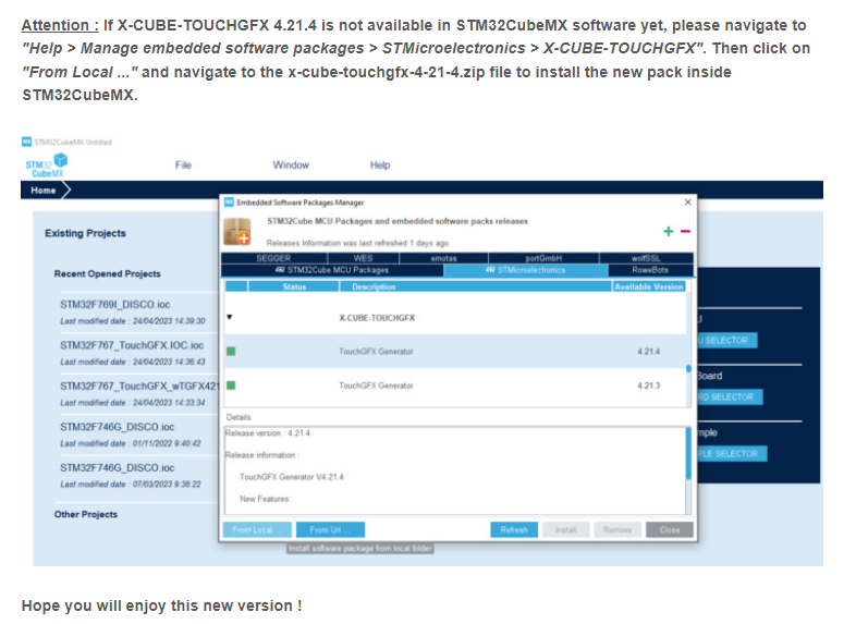

Hello @MPath.4,
You can manually install the generator, by following the steps described at the bottom of this post.
/Yoann
