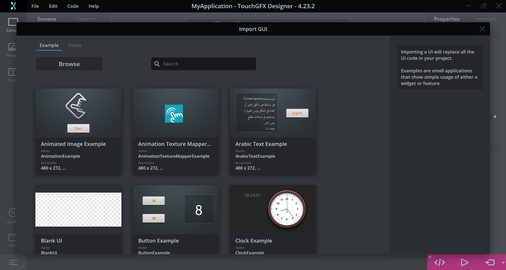

If I've understood your situation correctly, you don't have a TouchGFX project generated by STM32CubeMX. Instead you have a GUI example instantiated from TouchGFX Designer, and you want to connect it to you STM32CubeIDE project. The easiest way to do this is to create an empty TouchGFX project as I mentioned in the previous response, and then go to Edit -> Import -> GUI
Importing GUI
Here you can choose to import either an example, a demo, or even a GUI that you have created previously (by clicking on Browse).Then all the required files will be added to your project and they will be reflected in your STM32CubeIDE project as they should be.

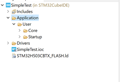

To use TouchGFX in your project, you first have to enable it from you STM32CubeMX project (or .ioc) file. For instance, I created a sample project to indicate the process. Initially, I have an STM32CubeIDE project looking like this:
STM32CubeIDE project without TouchGFX
Then, I go to the SimpleTest.ioc file and enable TouchGFX from Software Packs -> Select Components. Next, I generate code from STM32CubeMX with the Toolchain set to STM32CubeIDE and 'Generate Under Root' deselected

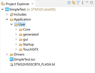

Afterwards, I navigate to the generated TouchGFX folder and run the project. I create my desired GUI and generate code from TouchGFX Designer. The structure of the resulting process will look like this:
TouchGFX project directory
Eventually, I remove the previous project from the STM32CubeIDE workspace and open the .cproject file inside the STM32CubeIDE directory. The result will as follows:
STM32CubeIDE project with TouchGFX
As you can see, generated, gui, and TouchGFX folders are added to the project.

I understand the point you are making. This is because the demos and examples available on TouchGFX Designer are based on the simulator, so, they can be easily imported into other project.
Importing GUI
