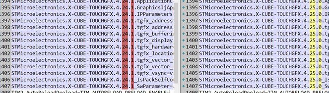

Dear Gfx Team,
I worked on a project using CubeIDE 1.17.0 and GfxDesigner 4.24.1.
I installed and un-installed 4.25.0.
Now, when I open \TouchGFX\mcu_project.touchgfx with 4.24.1 and press F4/F5, the version in \mcu_project.ioc is changed from 4.24.1 to 4.25.0.
Why is that and how to stop it please ?
Thank you

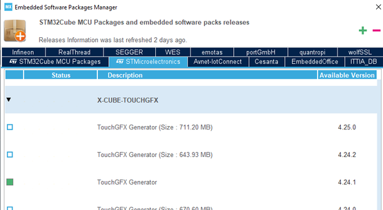

Hello @ferro ,
How did you uninstall TouchGFX?
When you open STM32CubeMX, go into "Help" => "Manage embedded software packages" => "STMicroelectronics" => scroll down => "X-XUBE-TOUCHGFX", what version do you see there?

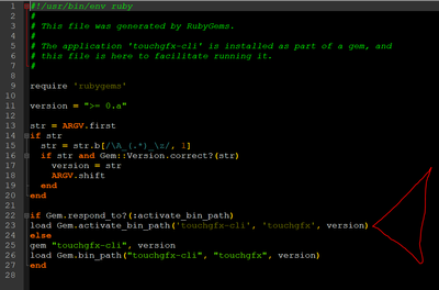

line 23 in file "C:\TouchGFX\4.24.1\env\MinGW\msys\1.0\Ruby30-x64\bin\touchgfx" is here
load Gem.activate_bin_path('touchgfx-cli', 'touchgfx', version)No idea where "activate_bin_path" could be set. I looked into my OS environment variables and nothing with 4.25.0 there.

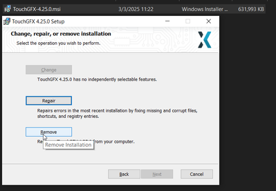

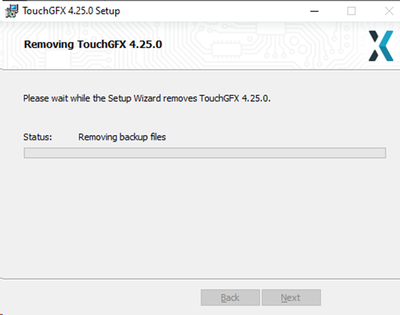

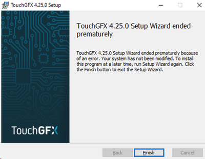

Back to 4.25.0 install/uninstall. During running uninstall from TouchGFX-4.25.0.msi, I got error screen. I copy here last 2 screens
What do you think ?
