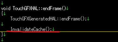

I had the similar situation.
I found the text flicker and below is countermeasure. It's just for your reference.
TouchGFXHAL.cpp

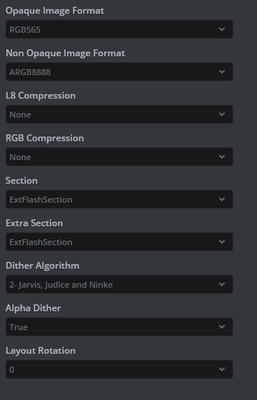

This is my TouchGFX default image configuration, and the RGB565 format option is not available in the Non-Opaque Image Format.
and, i'm sure this is cache issue.
because, for a moment, some parts of the tearing screen were flickering, displaying the correct colors.
TouchGFXHAL.cpp
