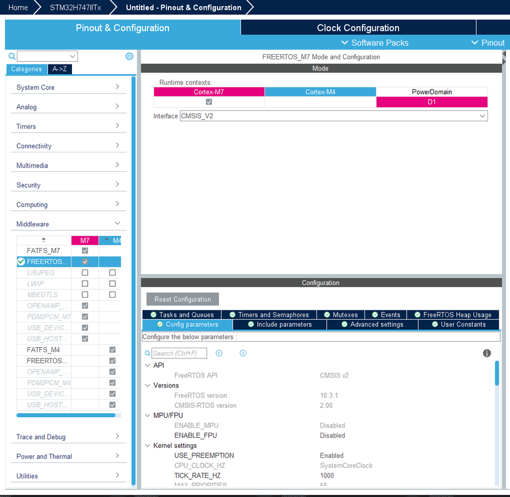

@Martin KJELDSEN @Osman SOYKURT Just to confirm, I need to choose FREERTOS in the code generator (as well as configuring everything needed), enabling CMVIS_V1/CMIS_V2 (Probably will go with V2 since it seems cross-compatible and if I go multi core it'll be required) and then manually moving the needed generated files into ChibiOS (removing the FreeRtos specific stuff) and starting a new TouchGFX task for it?
Once I have the CubeMX configuration, i can generate TouchGFX applications using that config and also add it to the ChibiOS.
Is there any steps that I'm missing?
Thanks!
2022-06-07 12:48 AM
Hello DOkaz.1,
Yes it seems to fine with this steps. @Martin KJELDSEN can you confirm ?
/Osman
