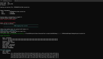

2025-02-04 10:11 AM - edited 2025-02-04 10:17 AM
I tried to execute the script inside the Flash scripts folder, but when I run LoadAll.bat, I get the error 'failed to erase memory'. I generated the .hex and .bin files by building the project in CubeIDE.
I positioned the BOOT1 switch to the right before executing the script.
Maybe I did something wrong. Do you have any suggestions?
