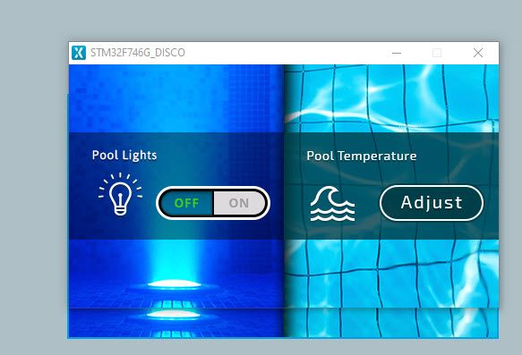

Ok. Just installed the support files for the same target STM32F746G_DISCOVERY kit -> after this installation, the TouchGFX simulator ran fine. Took less than 5 minutes but numerous support files were downloaded in the background. Very impressive toolchain as of this latest review. We can review your installation over TeamViewer once you send over the credentials.

@Mon2 solved my problem with teamviewer. he is very very gentleman and good person. my problem is just windows 10 user name that has space and some character. i reinstalled windows 10 with valid user name. so touchgfx is working fine.:ok_hand:
