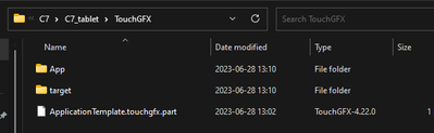

I've installed TouchGFX version and with STM32CubeMX generate code but in the TouchGFX folder does not find .touchgfx file. What is the problem?
Stm32CubeMX version 6.8.1

Hello Heyo.
CubeMX generates the .part file. You can open this file in the Designer. Have you already done that?
Remember to install the 4.22 Designer also.
Best Regards
