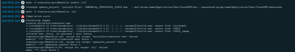

2019-02-09 11:04 AM
Hi @Martin KJELDSEN - may be facing the same issue in trying to assist another developer using the STM32F469i-DISCOVERY kit. Posted on another thread.
Can you advise on what may be the root cause of the following? Any idea to fix this? Thanks.
2019-02-11 1:07 AM
Hi @Mon2,
Looks like linker fails on locating three libraries. Can you check your application for the presence of these? (Inside Middlewares/ST/TouchGFX/lib). If they're present there the Makefile is probably pointing to the wrong location.
Let me know!
Best regards,
Martin
