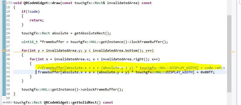

OK, So I did one experiment. I put QRCodeWidget qrCode outside MainScrenView (means like global class) so code stared working without hardware fault and i can able to see one black pixel box on display. But there is one issue. I explained it down.
QRCodeWidget qrCode;
void MainScreenView::setupScreen() {
QRCode code;
qrCode.setXY(30,50); //From widget
qrCode.setQRCode(&code); //From QRCodeWidget
qrCode.setScale(4); //From QRCodeWidget
add(qrCode); //Add to root container of your screen (view)
}So there are 2 screens in my project, First screen is logo screen which will go on display during power up and post 1 sec , my main screen will come which has QR code. and this was working fine when I didn't included QR code part.
Post adding QR code(updated one), logo screen started moving after 1 sec but now move is too slow . it takes like 10 secs to shift screen to main screen from right to left.
Not sure. Any suggestion ?
2020-04-29 12:20 PM
Updates:
Issue was with the code written at QRCodeWidget::draw. Seeems like highlighted code was making things slow. I replaced this with dummy value and this started working fine.
As this is working fine, I have below question. Please help.
1) Whats is the correct way of passing value of QR pixel ? Should I pass similar to above highlighted code from some QR pixel array generated by some library.
2) During Run time if i want to update QR code, How should i make touchgfx to do it ?
3) If I want to clean QR code during run time, how should i do ? Post QR erase , it should go back as background color/image.
4) Suppose I want to draw one circle ( this shape may differ based of some logic, Circle is just for example), so i m planing to use same QR widget class as during that time QR code will not be used. I want that background should not change, just wann put shape. How can I achieve this while remaining background as same. Any support from touchgfx on this ?
