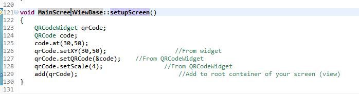

2020-04-28 9:42 AM
I added code inside my main screen view. I just want to put some dummy QR code for quick test so commented out setQRcode part but post below code, program is going to hard fault.
Should we generate QR code with some open library and pass those pixel in qrCode.setQRCode ?
Please suggest.
PS - I updated code as below, but still it didn't help. code is going to hardfault.
2020-04-28 10:30 AM
code.at(x,y); will just return the value of the QR code at that spot so you won't gain anything by calling it, If you look at draw() for QRCodeWidget, you'll see it loops over the qr-code width/height and asks for the value at each index of the code to draw it into the framebuffer.

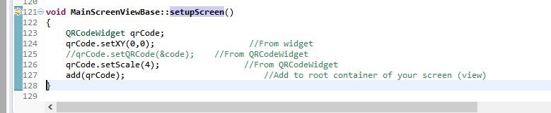

2020-04-28 10:39 AM
Yes, my code is working fine without adding QR code. How should I make it work ? Please suggest ?
Also code is not going to QRCodeWidget::draw, Before this code is getting stuck at hard fault. I added code at void MainScreenViewBase::setupScreen() .

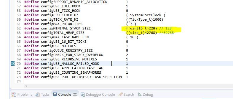

2020-04-28 3:47 PM
Using an RTOS? Try increasing stack of the task and the general heap.

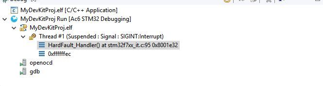

2020-04-28 9:48 PM
Yes I m using RTOS. i tried increasing it but no luck.
Also I am not able to track where exactly its going for hard fault. Stack callback is like below.

2020-04-28 10:13 PM
That's just the heap. Did you increase the stack size for your task?
