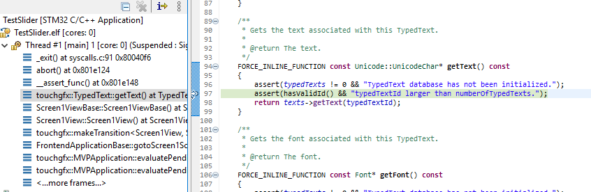

- Elf compiled by STM32CubeIDE does not work.It crashes when initializing the TextArea1 in Screen1ViewBase
Unicode::snprintf(textArea1Buffer, TEXTAREA1_SIZE, "%s", touchgfx::TypedText(T___SINGLEUSE_YO0H).getText());
either by not passing an assertion in touchgfx::TypedText::getText() (assert(IsValidID...) or some other times (I cannot say when) by triggering the MemManage_Handler.

2023-08-03 3:49 AM
Please, follow the link to get the zipped project.
I also enclose a capture of the stack when running the compiled version from STM32CubeIDE.
Thank you in advance.

2023-08-04 12:43 AM
You are right!
I have that in mind when I use the CubePrgrammer to restore the boards to their default demo, but I overlooked it in CubeIDE. Thank you for your help.
